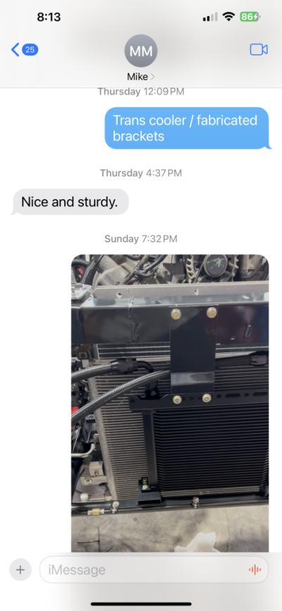

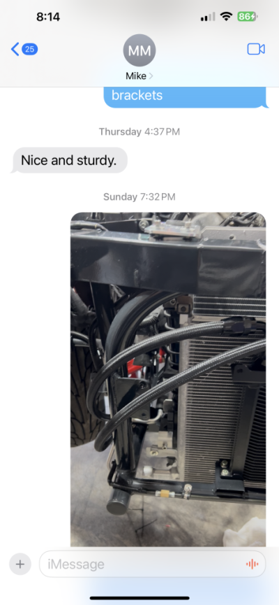

I used -8 AN for my transmission lines and I was expecting it to be harder than it really was. I’m running a custom Transmission cooler and the factory lines wouldn’t work as is.

Stock GT lower cooling hose (running out by the oil filter) is 1.75in. If you swap oil filter plates to an aftermarket one (like the MMR unit) there's AN options. Big AN fittings can be pretty expensive, though. Upper might be a little harder as I believe it's block-specific. There's probably someone out there who makes an AN version, or you could have one fabricated if you know someone who can weld it up. If you just want the braided look, there's braided sleeve kits that have AN-looking aluminum covers. Done right they actually look decent.
As for the trans-cooler, running a hi-stall TC and a built trans, I have heat to spare. I was running a large plate-fin cooler but I'm in the process of moving it to the back of the car with a shroud and fan. There's a good amount of heat and I don't like having it bathing my radiator and condenser.
Long as you don't change the tubing diameter you're good. If your cooler isn't spec'd for the same flow as the line (like putting 8AN lines to a cooler made for 6AN) you'll have problems due to pressure increase. In the setup I've been running for a few years, I kept the hard-lines up until just behind the radiator, then cut off the stock ends and added AN fittings. Then ran braided line to my cooler. I have used the old transmission cooler as a steering cooler up until now (going electric).
Also, I can't stress enough how important a dedicated transmission temperature sensor/gauge is. The stock computer reading is for sh*t.
