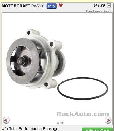

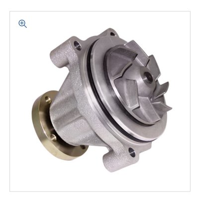

I would recommend against any claimed “high flow” water pumps.
I tried an Edlebrock branded high flow pump with a similar veined design as the one you linked and it performed worse for me. Not sure if it was cavitation, but the Motorcraft unit kept temperatures lower and more consistent FWIW.
You can see the “high flow” design first without the vein backing, and the Motorcraft design second with the backing.

as he ( stockish ) says... keep the waterpump stock . No need for a "High performance " WP...

Stock water pump got upgraded significantly it just isn't justifiable to buy the Edelbrock one that costs hundreds more, I was gonna but at that point you are better off buying a electronic water pump.
