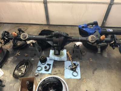

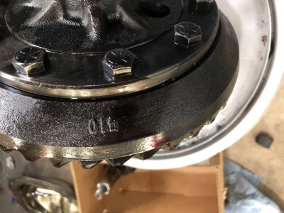

Replacing the bearings in my rearend. Diff cover has a sticker that says 3.55. Pulled it apart yest and saw “410” in the ring gear.
My plan is to just swap bearings and put it all back in, didn’t plan on checking anything…bcz I don’t know how. Watched a vid where the guys rebuild kit came with a different brand bearing, Koyo (I think, which is what my rebuild kit has) but I can’t see the brand on the bearings currently on there. They do look alittle different but surely I’d think they’re the same size?

And then again, according to the pics he posted, the thing is sitting on the garage floor completely tore down. Counting the teeth is 100 percent accurate. And the only way he can check it at this time. Unless he puts it all back together and spins it. Then he can take it back apart and count the teeth just to verify. Idk, am I looking at the pics wrong?

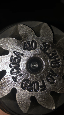

Hi OP,
Just to help out here, the gear set you have is a genuine Ford Performance 4.10 gear set (all Ford Performance gear sets are made using the 2-cut face hobbed machining process.....1 of the visual markers of a face hobbed gear set is the rough finish of the back side of the ring gear where those markings are.......to date only Ford\Ford Performance uses the 2-cut face hobbed machining process to cut all their gears for the Ford 7.5"\8.8" axles........all 5-cut face milled Ford 8.8" back side of ring gears are machine finished thus smooth & are made by the aftermarket manuf's) & Ford marks both the pinion & ring gears w\ the gear ratio number (that is the ring gear ratio you took a picture of) to maintain pinion\ring gear matching.
Otherwise, the methods that others have already mentioned will also get you what you want to know concerning the current gear ratio you have.

The pinion gear is also stamped
