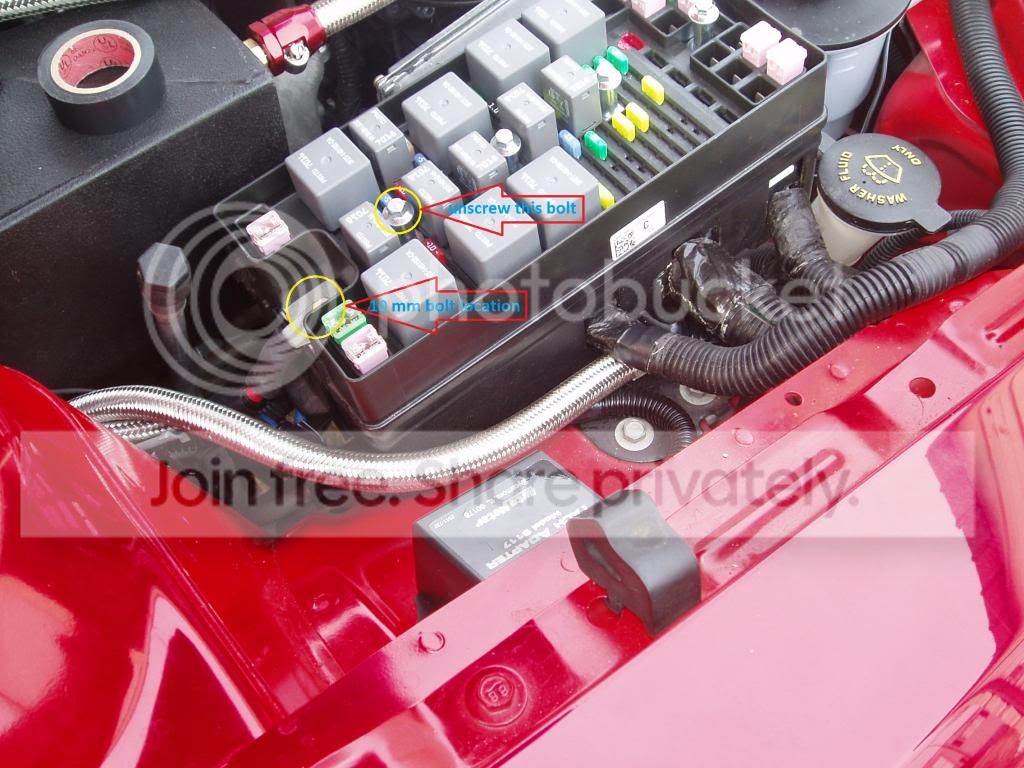

1) roll each window down a few inchs before disconnecting the Neg battery cable.
2) unscrew 10 mm alt bolt and 1st small bolt on PCM

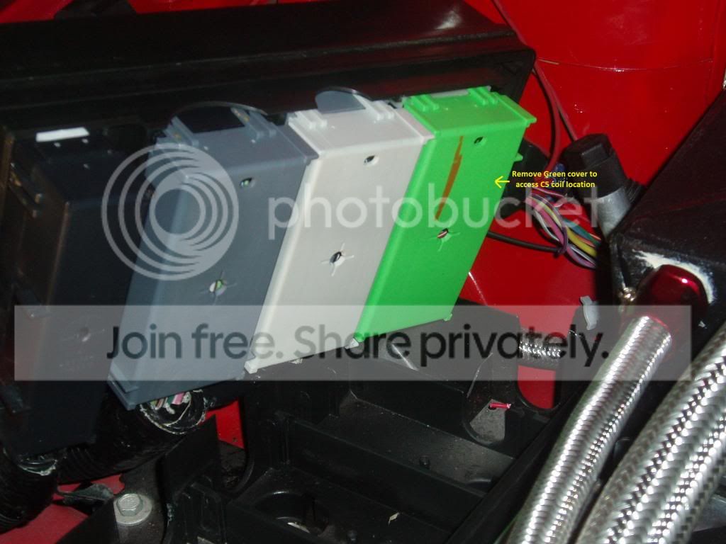

3) unclip the PCM , then turn over to get to bottom of pcm
4) take a small flat head screw driver and carefully unclip the small two clips on both bottom and top of green cover,this will let you remove the cover.

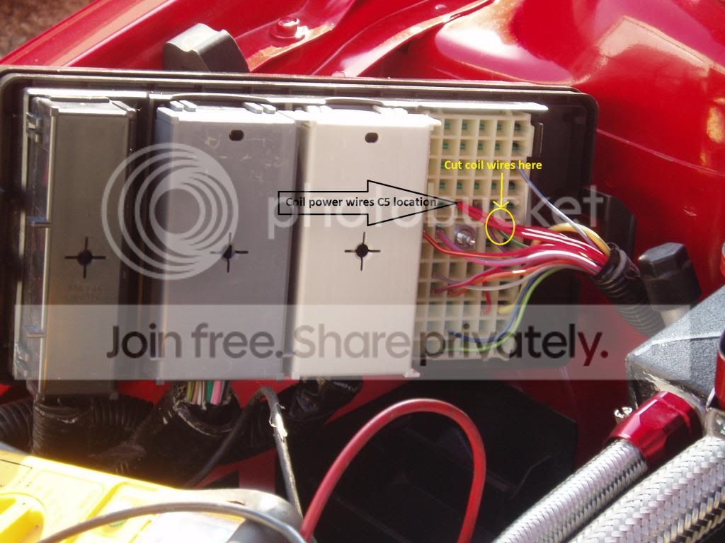

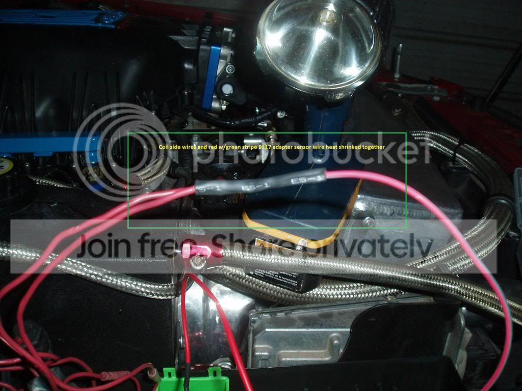

5) You'll look for the C5 location as pictured and cut the two red wires.

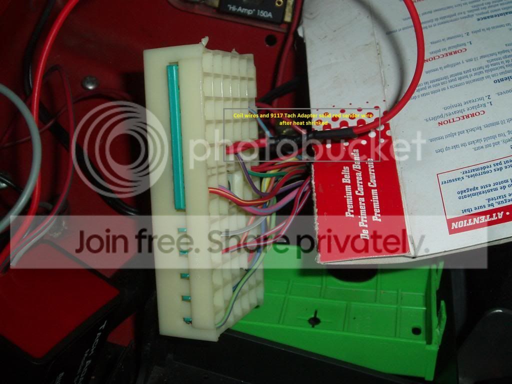

then twist together the two red wires on the PCM plug side slide shrink wrap over wires, then twist together solid red 9117 Auto Meter Tach adapter wire , then slide shrink wrap past twisted wire part so as not to get the shrink wrap hot ,then solder wires together, once cool enough slide shrink wrap on and shrink with heat.

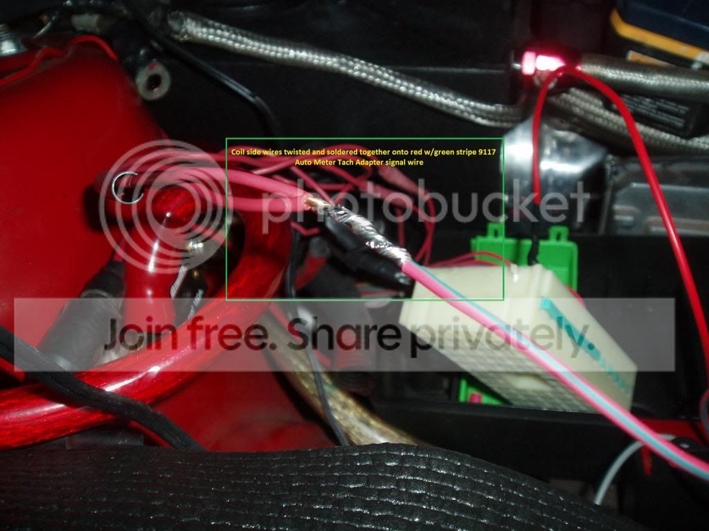

6) twist the red coil side wires together and solder them to the red/green
stripe 9117 tach adapter wire, by using same soldering and heat shrink procedure.
7) now you can put the green cover back on and put the PCM back together, before proceeding any further. then screw small bolt back down and connect the alt wire and screw down the 10 mm bolt.

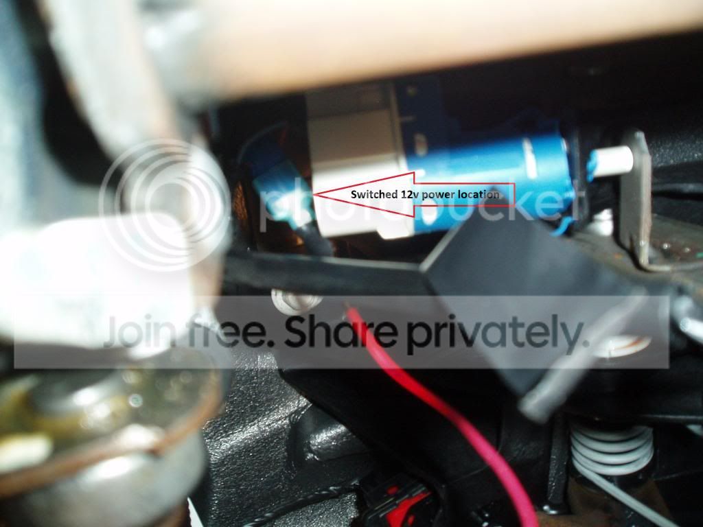

solder the red wire on the shift light to a 12v switched power source. I used the blue & white brake switch for my souce
