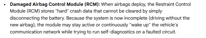

Since all was well before the airbag deployment. That is where I would start troubleshooting, but an impact from an accident can certainly cause many issues. I did some searching, and aside from the many possibilities, this stood out just a bit (for starters).

That’s why I’m puzzled. The RCM can cause an airbag light or a draw from the module staying armed but it never keeps the dome light lit. The Smart junction box has no physical wiring path to the Restraint Control Module to control done lighting. If the front end wiring harness was crushed or shorted out, a chafed wire could create a ground path that wakes up different modules, but that would be illuminating warning lights on the dash and be throwing codes, which it isn’t doing. It’s weird.
