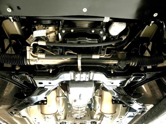

One side at a time?I used a solid block of wood at the front of the engine where the oil pan bolts to the engine block and 3T floor jack. Done it many times…
Ah, I see.
Actually when I get off the road in a couple weeks I'm going to clean it all up underneath there.You keep that thing in a plastic bag? Jeez, that's clean. Looks like it's never been on the road.![]()
Straight up, Across the front or on the two bolts each side in front?I used a 4x4 at the oil pan bolts.
Right across the front. I seem to remember there being just enough room between the dampner and the pan.Straight up, Across the front or on the two bolts each side in front?
