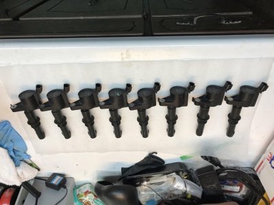

Ok so the scanner is an Ancel ad410 and the code was p0352

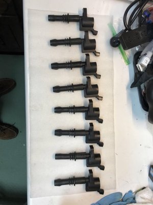

Ok so I put in the OEM coils and drove about 5 miles. Still feels much better, not hesitating, power seems good. Still bogging when I decelerate. Sometimes down as low as 300 rpm.
