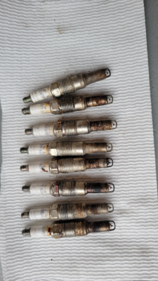

Oh and @GlassTop09 only one plug was really even fouled. In my infinite wisdom i forgot to keep track of which plugs were in which cylinder though. But i believe the fouled plug was on the driver side
Ok, these show that the engine's overall fueling, AFR is pretty good across both engine banks so the 1 plug that shows some fouling is indicating a specific issue w\ 1 specific cyl (like a potential bad coil not getting plug tip hot enough to self-clean or intake valve stem seal(s) leaking oil) so you'll have to chase that down. You may have just found your issue w\ sluggish low speed operation.
At 1st opportunity I'd lose the MSD coils & go back to OEM Ford MC DG511 coils as already suggested by others.
