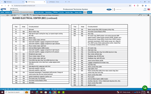

As you can see Fuse 47 controls alot of items. Could be any of these items. Could be wiring to them etc. First step is to pull codes. Unplug all of the items shown and make sure there is no moisture or condensation n the pigtail. Start there and let us know what you find.

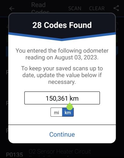

I also pulled the codes through my blue driver and got the following:
P0010 "A" cam position actuator bank 1
P0020 "A" cam position actuator bank 2
P0102 "A" MAF circuit low
P0446 EVAP system vent control circuit
P2008 intake manifold runner circuit open bank 1
P0645 A/C clutch relay control circuit

I believe you've found the likely source of your problems. At least it's usually my experience most problems are self imposed. Clear the codes then start by removing one connector at a time; thoroughly blow them out w/compressed air; check the pins; connect back up and retest. Hopefully, that clears a few codes then you can concentrate on any outliers but it sounds like you're on the right track.

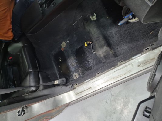

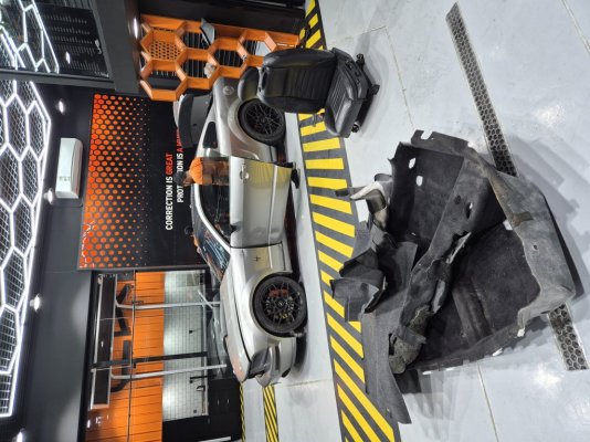

There was a lot of water intrusion sadly but it wasnt from the drains. It was because of how high water was, but the issue started before the water level got to a point where it entered the cabin. That's why I don't think it has anything to do with the secondary fuse panel. But I'll check it just in case
As you can see, there was a lot of water in fact it there was more but I took the photos two days after it happened.

I did what you said and in fact it did decrease the number of codes, when I ran my scanner the first time right after it stopped raining I had about 28 codes, and after letting it dry and cleaning the connectors I'm left with 6 codes, which actually go away when I replace the fuse but as soon as the wrench light comes on the codes come back as well as the fuse being blown.

Ah, Ok, that's a problem. How high did the water get? Sounds like you have water (and possibly corrosion) in the cabling/connectors causing a short. That will need to be dried out before you do any additional troubleshooting. If it were me I'd start by pulling any of the cabling in the engine bay (related to the remaining codes) that got wet and disconnect/remove each of the cables that were drenched to dry and blow them out. Pull the fuse box in the engine bay and inspect it for water/corrosion. After drying take a VOM and verify connectivity on any cables you removed from end-to-end and then look for shorts pin-to-pin before reinstalling. Then check codes again.

The water level was about an inch when it first occured. I took the car to a detail shop and they removed the carpet and interior and dryed it all as well as an interior deep clean.
I removed The fuse box when I was cleaning out the connectors and it didn't seem like it had any water damage. But I cleaned it too just to be sure.
