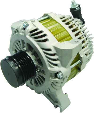

The alternator seems fine??? You should go have it tested and make sure they test the diode. The symptoms you describe are often caused by the alternator going bad. The voltage might be correct but a bad diode can cause these issues. If you do replace it get one for a 2010. It's a different spec than the ones for 05-09.

What’s different/better about an alternator from a 2010?
The 09-10 GT was fitted with the better quality, more reliable Japanese-made Denso alternator.
That said, you might still be able to find a remanufactured Motorcraft 05-08 GT alternator from a Ford stealership. They're better quality and less failure prone than the originals that were fitted from the factory.

Thanks all for the info. I grabbed that alternator and will keep it on the shelf just in case.
