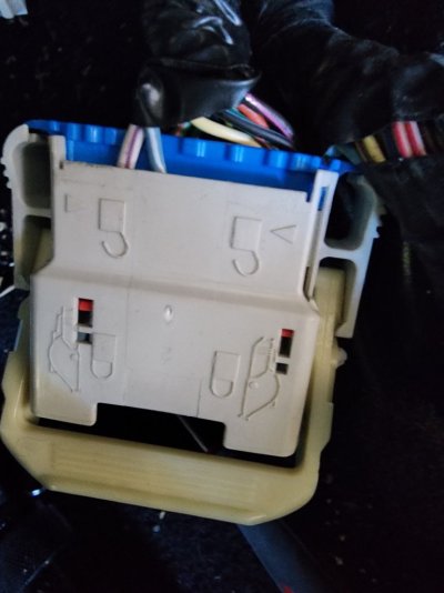

Does anyone know how to properly disconnect the bottom harness from the C210 connector (grey connector next to the SJB? I can remove the top connector but can't figure out the correct way to release the bottom connector, which is probably a bit corroded inside from water damage. I've attached a photo for reference. It is upside down for the photo and I've already removed the top harness from the connector

That pulls the upper harness from the box. It doesn't seem to do the same for the lower harness. If it should, then it must me mightily stuck in place.

So actually, I can lift the blue pieces (they seem to be position holders and possibly to help keep moisture out), under them I can see male connectors heading the the center "floatin" board. I haven't yet found how to remove them as a unit, rather than individual wires. Still pushing and prodding.

I'm over this particular hurdle. I finally got a good enough look at things to realize that this probably sold as a harness already connected to the C210. Luckily I only have a light white dusting everywhere and will clean that with contact spray. Moving on the SJB itself.
