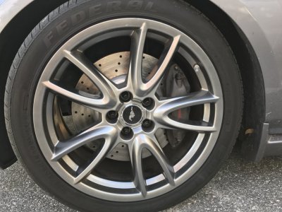

I bought the S550 4 pistons also. Even with light grinding, couldn't
get them to fit with my wheels unless I used at least a 3/8 spacer.
They stick out a good 1/4 inch more (vs WMS) than the Chinese castings
(never did measure the Ford Brembos).
Yep exact same issue I ran into. Now granted I am running S550 wheels which have weird backspacing/offset, but I only had to run a 7 or 8mm spacer to clear the Brembos with them. The S550 calipers were going to require, as you said, 3/8" or 1/2" spacers to clear and I didn't want to install longer studs so I abandoned that idea. With the Brembos I just ran ET (extended thread) style lugs and it all works just fine.

Same here, ended up with 8 mm spacer using stock Brembos and chinese bullet wheels.
At least a spacer that thin still gets you the ability to be hub centric and keep stock studs (wheel dependent somewhat I guess).
The S550 rotor face seems set much farther in, vs WMS, than S197's. I also found it interesting that Ford used the same size master cyl for 2 piston GT, 4 piston S197, and 4 Piston S550 calipers. The difference is piston area of 2 piston GT's vs S550 4 piston is huge.

From what I saw, S550 wheels have a 3/4" taller "hat" in the middle of the rotor. I never checked whether or not the wheel offset was the same or not, but because of that the rotor sits further back in and the bigger calipers fit without issue.
