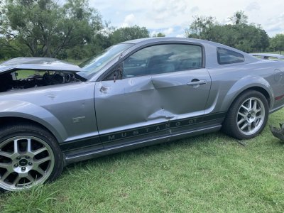

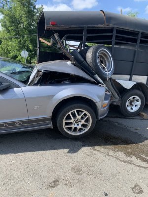

So I totaled my 06 GT. Insurance company said I could keep the car for $933. I just replaced the bad 4.6 with a used 4.6 with approx 80k. New oil pump, head gaskets, ang so on. Engine has headers, flow masters, cai, short shifter and nice interior. I found a 2005 V6 with a bad engine with automatic. Is it it worth pulling my 4.6, tr3650 and rear end and using the V6 car? I could just sell my parts. Not sure what to do. I have the shop and tools to do the work and I have had the engine and transmission out of the GT before. Let me hear from y’all
The V6 car is same color and is 1500-$2000.

As long as your harness/computer from the GT is good you could but just know it's going to be a LOT of Work. If you're up for it though have fun.

Should be a relatively easy swap. As long as the gt still starts and runs. Looks like a prety hard hit. Better be sure there is no hidden drivetrain damage.

Yea, if the frame rails are bent bad enough that could reveal a cracked mounting point on the engine block or transmission to engine mounting surface cracks and transmission mount surface cracks.
