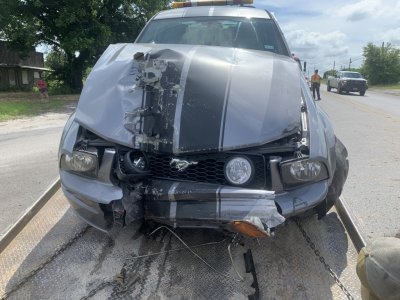

So I totaled my 06 GT. Insurance company said I could keep the car for $933. I just replaced the bad 4.6 with a used 4.6 with approx 80k. New oil pump, head gaskets, ang so on. Engine has headers, flow masters, cai, short shifter and nice interior. I found a 2005 V6 with a bad engine with automatic. Is it it worth pulling my 4.6, tr3650 and rear end and using the V6 car? I could just sell my parts. Not sure what to do. I have the shop and tools to do the work and I have had the engine and transmission out of the GT before. Let me hear from y’all
The V6 car is same color and is 1500-$2000.

As long as your harness/computer from the GT is good you could but just know it's going to be a LOT of Work. If you're up for it though have fun.

If I found myself in your situation I would probably do it. I would approach it like you are doing a complete color change on the V6. Disassemble the entire wrecked GT first. Take note of what is damaged and needs to be replaced and box/bag/organize everything you are taking off. Now disassemble the entire V6. Except for obvious things like the glass/headliner/etc. Now start transferring everything over from the wrecked GT. Get the drivetrain started and running first. That will motivate you to finish up with the suspension and interior being last on your list. Don't throw away anything until you have a complete running car. Whatever is left over after that can be sold for parts and hopefully make your $933 back and maybe even some of the $1,500 you spent on the V6. How much is a complete running V6 drivetrain worth anyway? And the extra set of seats you will have leftover. Those are worth some coin too. And the extra set of V6 wheels. Somewhere out there is a kid with a 4cyl Ford Ranger that would love to have that stuff.
If you have the skills, tools, and time then make lemonade out of lemons. Shops that specialize in restoration do this stuff all the time. It could be a good learning experience for you. Hopefully you don't have a wife that disapproves of two complete non running cars lying around for a few weeks.

Should be a relatively easy swap. As long as the gt still starts and runs. Looks like a prety hard hit. Better be sure there is no hidden drivetrain damage.

Yea, if the frame rails are bent bad enough that could reveal a cracked mounting point on the engine block or transmission to engine mounting surface cracks and transmission mount surface cracks.

True, both engine to mm brackets were cracked as was the transmission crossmember on the wreck I used to build up the drivetrain on my 2011gt/2014gt (i think) frankenbuild. I also ended up having to swap ALL wiring harnesses over to keep it simple and not deal with repinning between engine and body harnesses.
But maybe you don't have to worry about that last part with your early gen.
