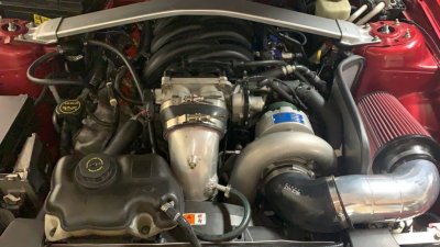

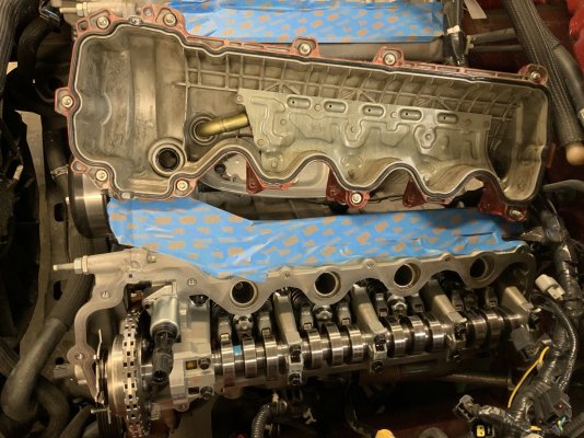

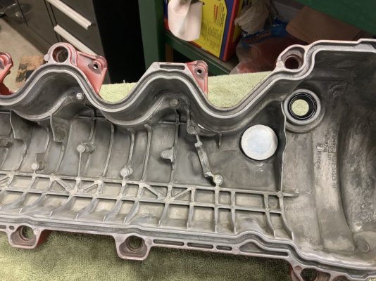

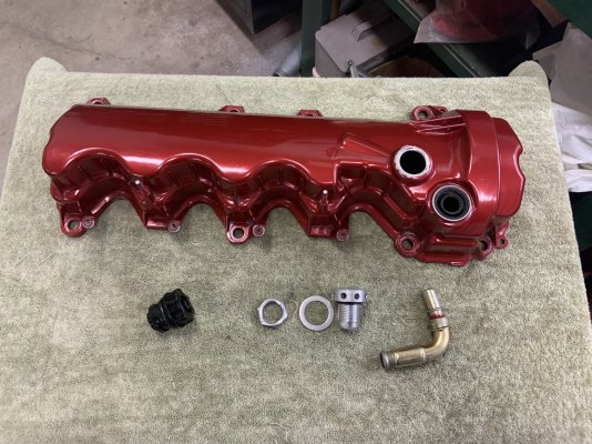

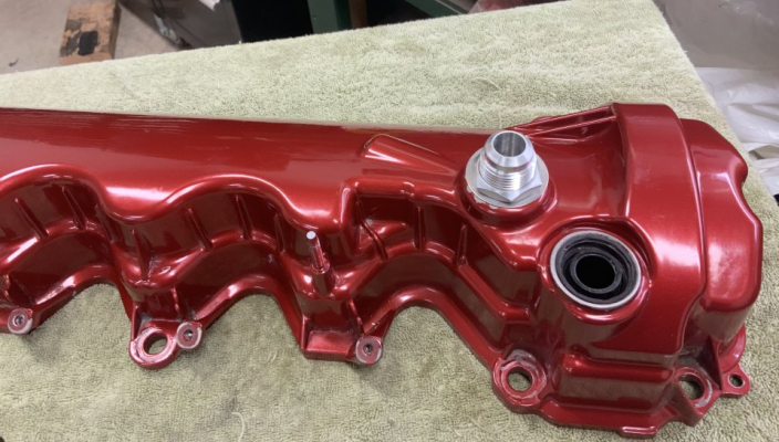

So for a standard centri setup, a catch can on the ds and just leave the stock setup on the ps, or get a breather for the ps? Either war, no need for two catch cans, correct?
Sep 13, 2019
85
8
Not sure if anyone is looking at this thread but I wanted to get some validation that I have my engine venting correct. As you can see I have an Anderson power pipe replacing the stock vortech intake so I didn’t want to drill a hole in it so I welded a tube to the intake to connect to the catch can. Also I installed a big red BOV and relocated the MAF after the BOV. I’m noticing now that I’m not catching oil like before so I’m wondering if I should tap the Power pipe and seal the other hole to match the stock vortech piece. Let me know what y’all think, thanks! F20B2DFA-78A0-4651-9598-C30363D039EE.jpeg
