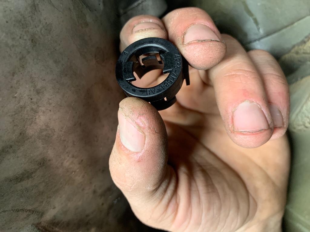

Replaced Clutch and TOB and broke this in the process so I ordered a new one, and for the life of me I can’t get the darn thing to stay seated in the bellhousing. Every time I depress clutch it pops out. Please any tips or suggestions to get it to stay??

It looks like it should just push & snap into place.
looks like it around the 14:10 mark. Wish I could help.
Maybe a little superglue?

Might sound dumb but. If piece on the end of clutch hose, the piece that plugs into the gromet looking piece in your hand is backwards hose will pop off when starts building pressure. Give you 1 guess how I know this.
