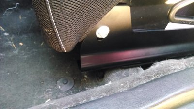

The side brackets are from Cobra, and bolted right up. I bolted two front bolts into the Mustang bracket and would need to drill holes for the rear. The side bracket doesn't come with the to-the-floor bolts. The Planted bracket re-uses the OEM bolts to the car. I can't imagine adding sliders to this setup. The Cobra brackets offer little in the way of adjust ability, and the planted brand mount raises things up about half an inch in the front, and a couple inches in the rear.
The seat is WAY more comfortable than the stock cloth seats IMHO.
The problem is that it sits higher than the stock seat. I was hoping to go 3 inches lower, and now its 1 inch higher...... I know I'm probably going to have to weld up something custom, so what are people doing about mounting seats? Do you cut out the part of the chassis the front of the seat bolts to?

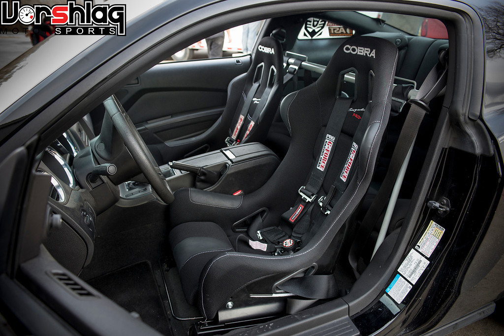

I always have to go to great lengths to make racing seats fit into cars for me, and I'm only 6'3". We've worked on seats for guys as tall as 6'7", and it starts to get tricky. We've probably done about, ohh, a hundred custom seat installs for folks over the years? These usually required custom lower "chassis" brackets and often sliders and customized side-mount brackets. For a dual purpose car we always try to use a slider, which makes the seat SO much more functional. That way it fits more than just one person, and you can often still use the back seat with a fixed back front seat.

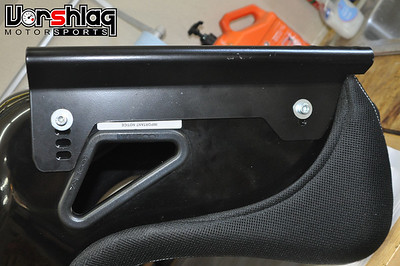

The gallery above has some of our seat mounting tricks shown. The side mount brackets from Sparco and Cobra and everyone else are always laughably too tall. Add the bracket needed to match these mounts to the chassis, and then throw in their slim-line dual locking slider (Cobra or Sparco) and you have often added 2" or more to the seat height from OEM. Its terrible, but you end up chasing hours of work to make it all work to fit anyone over about 5'10" with a helmet.

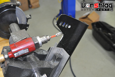

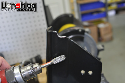

Getting these Sparco/Cobra/etc side mount brackets to work usually involves both the drilling of new holes (lower than the included slots or holes) as well as grinding the inside corners to clear the lap belt harness pass-thru guides.
These side mount brackets are supposed to fit the seat models from the same company, but they rarely do at all of even the included holes. You can see in the pictures above that we had to clearance the front to clear the fabric of the seat from this Sparco EVO seat, with Sparco side brackets. Just part of the fun of adding racing seats. :beerdrink:
Nothing can quite describe how WELL a properly mounted racing seat works, though. There are a LOT of variables that need to be addressed - the custom brackets, the correct slider, the seat angle, the fore-aft and lateral locations, the total seat height, the mounting hardware, and proper harness mounting/lengths/eyelets - so don't be shocked to see a four figure bill when getting seats installed by an experienced shop. It can add up to a dozen hours to properly mount two seats and harnesses, easily.
