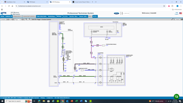

Dec 18, 2024 #1 T Tim Burns Junior Member Joined Apr 13, 2022 Posts 11 Reaction score 1 Location Birmingham, Al. 2012 GT. Any idea where the fuse is or where do I start looking to solve this issue. Any help is appreciated.

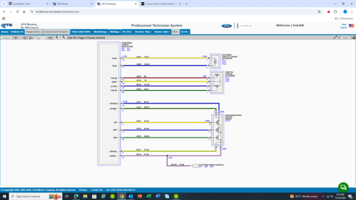

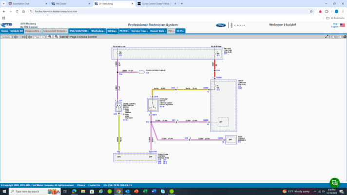

Dec 18, 2024 #2 86GT351 Senior Member Super Moderator Joined Nov 14, 2010 Posts 7,276 Reaction score 1,766 Location Sunny South Florida Hope this helps
