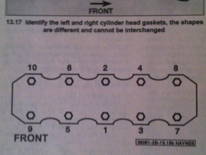

No thread locker... No anti-sieze... Just use some 30 weight oil on the threads and under the bolt head.
It is VERY critical to follow the torque / tightening sequence though... and I recommend using a degree measurement device for the TTY bolts. Like this: https://www.ebay.com/itm/2850854486...Bp6iHMJGlPXUAdpOm60NGsq-2G0U01R4aAlMDEALw_wcB
If I recall correctly it's something like you take them up to 30 ft. lbs. in sequence, then 90 degrees in sequence, then another 90 degrees in sequence.
