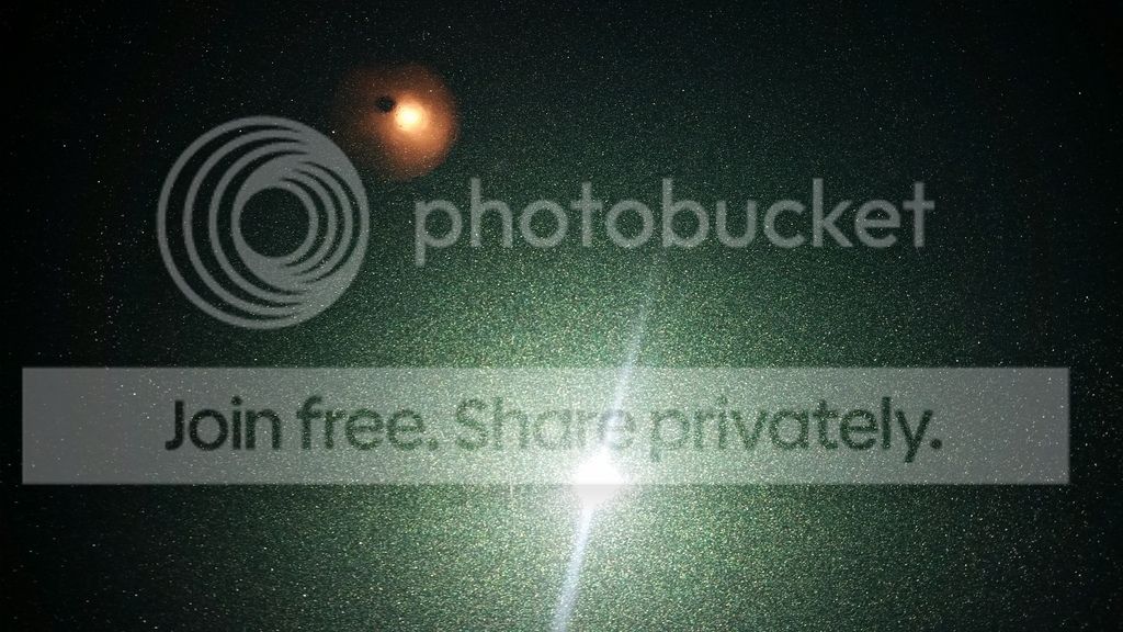

I bought a 2001 bullitt and am trying to do a 2 stage paint correction on it. The hood and roof have a lot of water etchings and small pin holes in the clear. I've already hit it with an orange pad and m105. Im afraid to go any more aggressive as I'm still a newbie at this. I'll attach an image and see what you guys think. I was using a PC with orange 6" pad. Im thinking I might need a 4" or a wool pad but like I said I'm afraid of going more aggressive as the etchings appear deep.

Zoom in on the amber reflection, you can kinda see what I'm talking about. I will try to take better pictures later today when I get home. If zooming doesn't work pm me your number I can text you the picture if you care to take a peek.
