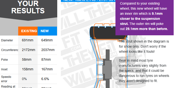

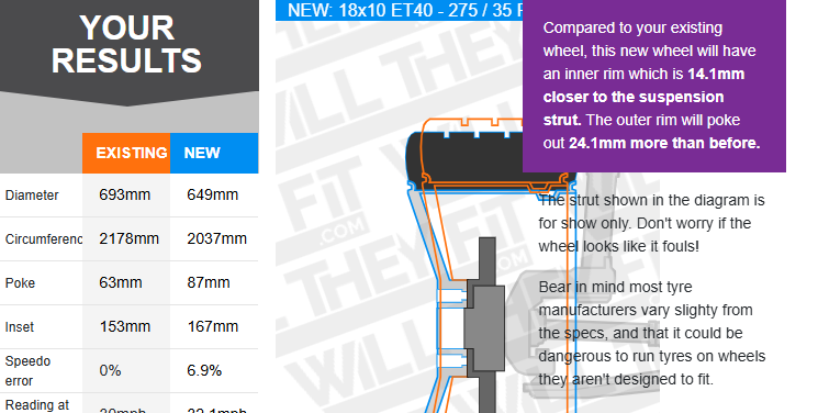

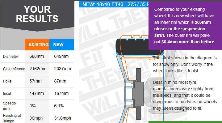

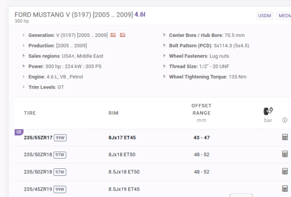

Hello, I am looking into a new set of shoes for my 08 s197 and would like any feedback regarding fitment/rubbing. From the research I have done it seems to be that this setup will work fine but just wanted to throw this out there incase anyone has had any issues. Any feedback is appreciated thank you.
APEX EC-7 18x10 ET40 | Michelin Pilot Sport 4S (275/35ZR18)
