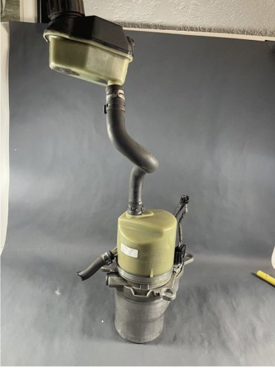

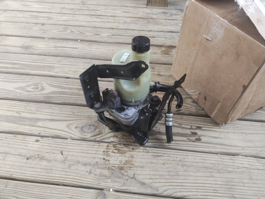

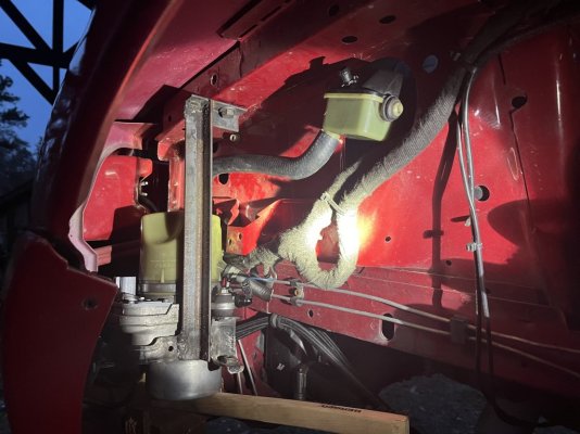

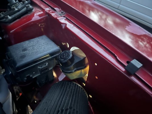

I started with the pump that has the fill built in, but didn’t like where I would have to put it. So I moved to the setup with the remote reservoir. They are the exact same pump just different tanks and fill points. 1000001002.jpegIMG_1069.jpeg

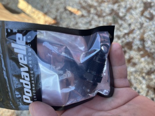

They require an o-ring fitting to convert to AN lines, and I got earls brand power steering high pressure hose.
My brackets are not pretty, but they do the job. I have to finish hanging the pump and the reservoir. But this is really all just an about as simple as it gets for power steering.
My buddy on here @white95 is running it on his coyote swapped sn95 as well. He introduced me to the whole thing. He does autocross with his.

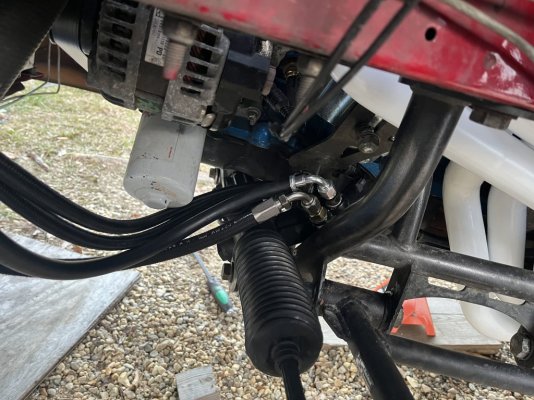

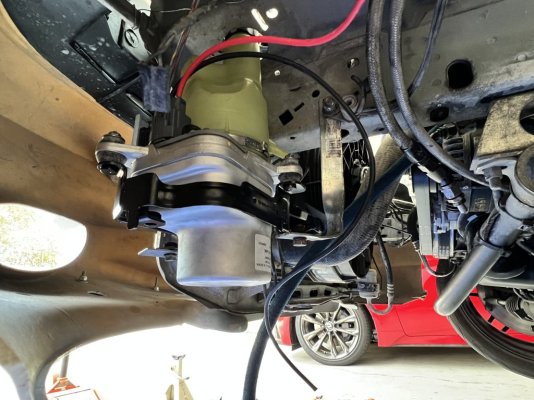

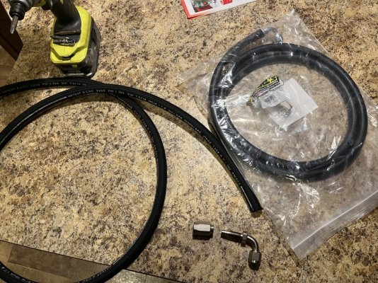

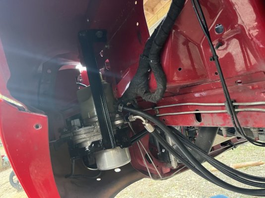

I’m running AN lines on mine, so conversion fittings at the rack, and some good high pressure power steering hose. IMG_1117.jpegIMG_1118.jpeg
