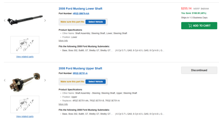

There is a U-joint in the steering shaft that can loosen up over time just due to wear & tear. Mine did. Issue replacing them is finding one is exceedingly difficult these days (if that's the problem). A good alignment shop should be able to pinpoint the problem in fairly short order.
Looks like there is an upper and lower section. Which one has the u-joint (or do they both)?
DieHarder
Nov 9, 2019
1,850
1,070
In my case it was the lower shaft (which is relatively easy to replace). If it's the upper might be lucky to get one out of a junk yard.

It was the lower shaft in mine that gave trouble but instead of the UJ coming apart and getting loose, mine seized with lack of use and age. Rock Auto does both upper and lower at good prices if its a 2012 as listed in your vehicles?
