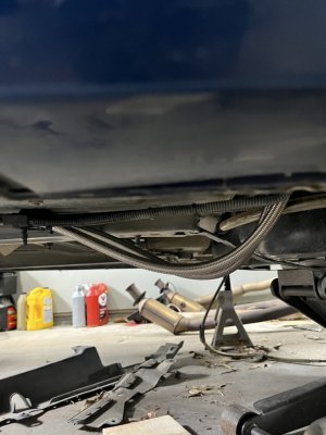

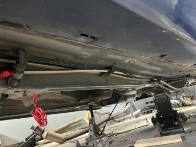

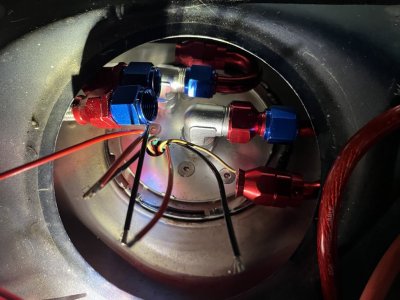

Got all this mocked up, not too bad, one main issue. I don’t recommend ever dropping the tank if you don’t have to. I did for the experience and thought it’d be easy but it kicked my rear for 2 days! Just couldn’t get it to fit back exactly the same. Took a guess on fuel line length and paying the price now. This is the only way the ends will screw together. If I try to swing them toward the rear of the car the hose hit the metal around the hole

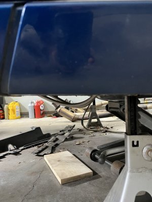

The hoses aren’t long enough to swing around and come in thru the pass side way. The hoses are to long that as it sits now they hang down this much
I have 2 choices that I can think of…
1. Trim out the metal and try to swing the hose more towards the rear taking up some of the slack.
2. Turn the elbows on the hat pointing towards the passenger side and install to 90 fittings…..this is what I’m leaning towards

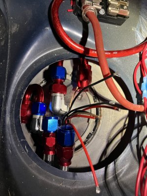

This pic is how it is now with the straights and hoses hanging out of the bottom
