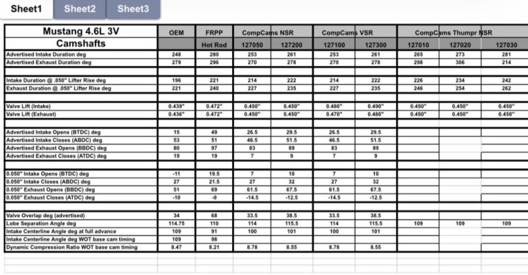

Perhaps someone more knowledgeable here can chime in on cam choices, but Hot Rods with their wide LSA will bleed boost more so not ideal for boosted applications, though they do sound nice :)
Also, I would think at the boost levels you are running, the VCT might be less stable due to the higher cylinder pressures so might be worth locking out regardless.

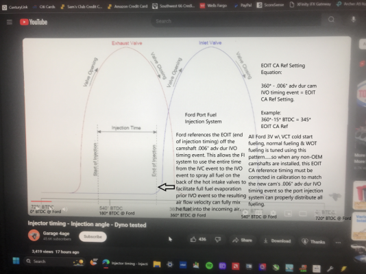

Ah ok............so all ended up working as it should.
My SCT tune (in car when I bought it) didn't change the IVO specified in the PCM (for the comp cam), and when I changed it to reflect the comp cam it actually ran better.
Lito got rid of the stumble at idle, now we just got to work on the rest... I'm not gonna give away Lito tuning secrets, but he had the IVO changed for the compcams so he obviously understands the 3V's better than the previous tuner did that tuned the car.
So now you see when you properly set the FI EOIT CA ref setting to match the .006" adv dur cam IVO event of any 3V camshaft--the way the creators of this platform, FoMoCo, designed this to be done--basic design & operation of a typical sequential port EFI fuel injection system so that all of the fuel is sprayed on the back of closed intake valves before the valves open so that all of the necessary transient fueling puddle fuel is also applied\maintained (facilitates cold start & accel\decel or "transient throttle response application"....) along w\ the calc'd fuel based off measured air mass flow then allowed the needed time for as much of this fuel to evaporate (only evaporated fuel will ignite & burn......ECU SOIT is automatically adjusted between the cam's IVC thru cam's IVO timing events duration so that the EOIT will always occur before the intake valves start opening thus all of the needed fuel is sprayed into the cyl head's intake port......), stuff just works right......exactly as FoMoCo set\programmed it all to do.
Setting this 1 setting properly will solve a MYRIAD of fueling issues w\ this platform...regardless of the camshaft profile being used & very, very few of the OEM Ford settings concerning fueling will need to be touched at all.......the engine WILL also make more overall HP & TQ as well due to the cyl head intake ports are also DESIGNED to accommodate sequential port fuel injection......is why the fuel injectors are placed where they are to begin with......by design, no mistake by Ford.
The mistake is from other folks--not Ford folks--who misunderstand\unaware of the basic engineering concept\design.....regardless of how long tenured in the tuning business & the proof is in the strategies where stock cams have been changed out & the OEM 345* CA ref setting that matches the .006" adv dur 15* IVO cam timing event (360-15=345) of the stock Ford cams is STILL set in the strategy & the new cam's .006" adv dur cam IVO event timing is opening the intake valves earlier than 345* CA, thus initially throwing this entire fueling system out of whack as the injectors will still be spraying fuel while the intake valves will be lifting off their seats initiating airflow thus the fuel has lost some evap time & can't properly maintain necessary fuel puddling to maintain clean transient throttle operations\response thus will be sweeping more raw fuel into cyls than necessary causing more issues as well......including decreased MPG, increased emissions & excessive engine oil fuel dilution......none of them are good. The larger the spread, the worst this gets.
Engine will still run up to a point........but not at its most efficient state. Just because it runs doesn't mean it's right.
No black magic & no secrets here...............basic engineering principle\design & function..........apply it correctly, you get correct results across the board. You have the cam card info.......this is easy to set. Just convert the .050" duration data (lobe lift) to .006" adv dur data (seat lift) then apply the math.........then input it into the strategy........done. Best done correctly up front so that you don't have to go behind & correct a lot of other stuff that was changed to "fix the issues" created by incorrectly setting this 1 setting up front......ie, chasing rabbits in the tune cal.
Front end tuning (initial setup & calibrations mostly.......) is what overall usually makes or breaks a tune cal when all external maintenance is properly accounted for.
My 2 cents.........................

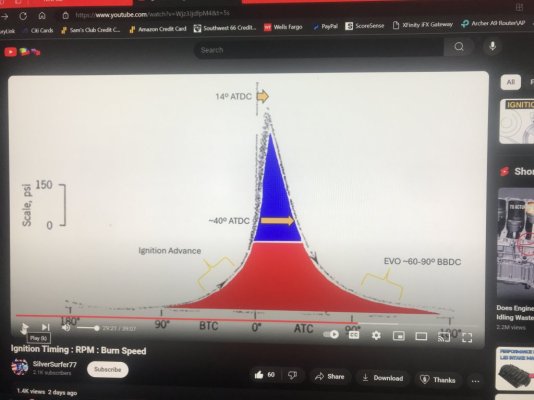

Lito dialed it back from 345, not the full 29.5 degrees, but further than the other tuners that tuned my car before had (which they just left at the 345).
Now what Lito is doing here you might call "black magic", but it's really based on some fundamental engine operational dynamics & physics.
Lab testing has determined that there are only 2 methods using port EFI fuel injection timing that will make the most TQ, 1 will be more efficient than the other while the other will make more TQ but won't be as efficient doing so.
The 1st method is the 1 I posted the picture of......this is the most efficient method for MPG, emissions & will make very high TQ output (the 1 Ford chose to use with 3V's........) due to the highly efficient use of burning as much of the fuel & air as possible inside of the cylinders.......high TQ output is created here from the ability to actually speed up the fuel burn rate (the main purpose of the CMCV's--charge motion control) from improved air\fuel charge motion created in the cyl\combustion chambers to maintain homogenous mix (air, fuel & some amount of EGR......depending on cam profile & amount of VCT cam retard being used......why these 3V's don't use an EGR valve......) thus also use\need less ignition timing to achieve the same amount of TQ output which will reduce the advent of mechanical pumping losses from igniting the air\fuel mix too early while the piston is still coming up to TDC during the compression stroke (from my testing & doing a lot of math, the critical ignition timing is around 24*-26* max, sweet spot is between 19*-22* for max TQ output w\ my engine using the NM version of E10 91 oct fuel @ 5486' elevation @ 65*F-100*F IAT--bad air, from 36*F-47*F IAT--good air--this drops to around 14*-15.5* max w\o knock due to the heavily increased air density thus engine loads.....).......after this you're starting to incur excessive force on piston coming up during the last part of compression stroke after ignition, countering the force on the leading piston being pushed down the bore during its power stroke to push vehicle forward as well as eating up some of the stored inertial momentum of the spinning flywheel\TQ converter to continue the crankshaft rotating instead of assisting the piston already in the power stroke to push the vehicle forward.....thus is netting some amount of final net TQ loss while incurring increased loading on rod bearings, crank main bearings, side loading piston skirts, wrist pins, etc. The further you go out, the worse this is getting.......this is why the term "MBT" in engine physics terms is really the engine coming into some level of force equalization across the crankshaft (why the engine stops making "extra" TQ & can start dropping TQ output.......), as long as the fuel's oct rating will allow these high cyl pressures to occur w\o knock. The big loser is the rotating component system........especially the bearings due to the extremely high cyl pressures being exerted on both sides.......wonder why cyl heads will eventually lift if the rods don't go 1st or bearings start spinning.........
This is what makes the GM LS\LT engines so potent........improved port then later DI\cyl air & fuel charge motion thru heads w\ improved chambers & quench\squish to make very high cyl pressures at much lower peak ignition timing w\o knock. Ford used CMCV's to achieve the same purposes along w\ the cyl head chamber design w\ the 3V--lacks effective chamber quench\squish--across the full RPM range.......whether the CMCV's are closed (simulating a longer runner at lower RPM's) or open in the process at higher RPM's.........
Food for thought if 1 is chasing peak HP\TQ numbers on dynos..............especially if you intend to drive\race your Stang year-round..........on a limited budget..........
The 2nd method is by injecting fuel thru open intake valves during the intake stroke---SOIT after the exhaust valve has closed---but EOIT just before the intake valve closes........simulating the process of DI except from the port. This method will make the most TQ output mainly due to the charge cooling effect from fuel spray evaporating directly inside of the cylinders\combustion chambers at the expense of some of the fuel not fully evaporating (due to the short time window for full evaporation thus some of this fuel doesn't get fully burned thus is expelled as soot......some of this fuel also can end up going thru the piston rings as blow by during compression thus can impact engine oil fuel dilution.....) thus not as efficient but will generate the most TQ due to being able to use more ignition timing to reach higher cyl pressure w\o knock.
Since Ford learned this, starting w\ the 2011 MY (the advent of the Coyote engine......) Ford incorporated this 2nd method to work in tandem w\ the 1st method by a process called OVI (open valve injection) to achieve the best of both methods of EFI port fuel injection where they make the most sense........uses the EOIT referenced off the cam IVO timing event as normal process until the engine loads exceeds a certain level (think high loads like WOT for instance.....) at which time the ECU will spray a determined amount of extra fuel thru the open intake valves to achieve the CC cooling to enable this engine to maintain higher spark timing thus enhanced high load TQ\HP outputs running 87 or higher oct fuel @ 11:1 CR........this is 1 of the ways that Ford can squeeze the amount of HP out of this engine while flattening out the TQ curve across the entire RPM curve.
Now, if 1 is fully understanding all of this from a dynamic POV, 1 could intentionally & strategically slip a little misted fuel thru slightly open intake valves during the intake stroke w\ this 3V to kinda achieve the very same result (charge cooling in CC's) as Ford already knew to do if they chose to by setting the FI EOIT CA ref setting in tune cal slightly later than the actual .006" adv dur cam IVO event timing of the camshafts being used.......that is, if you can accept the cons from doing this to gain a potential small peak HP\TQ gain vs setting this correctly.
I've tested this myself about 2 yrs back............determined it wasn't worth losing the far larger gain I got in MPG from correct EOIT ref CA setting while allowing the potential increase in engine wear thru increased fuel dilution, especially when my car is mostly a daily driver\cruiser duty & engine is high mileaged (184+K & counting).........have a 2nd vehicle (my Dodge RAM 1500 truck) to drive but it can't even come anywhere close to the MPG this Mustang can achieve & damn sure ain't as much fun to drive..........
IMHO, dedicated race car, game on........take full advantage of everything. A street car--especially 1 where you're using as a daily driver & is your only means of transportation........not worth this........set the FI EOIT ref CA setting properly & enjoy.
Provided below is picture of a US NACA 189 recording generated in 1922 of a gas-powered ICE engine cyl pressure plot vs crank angle where the cyl will make the most TQ against the crank throw at the highest effective fuel burn speed at that time.........that still stands to this day & every serious racing entity\OEM's on earth knows & tries to maintain to make max efficient HP\TQ.......... I find my engine using these Hot Rod cams hit this @ WOT at VCT 17* retard.......not the Ford recommended WOT 20* retard.......which corresponds to 10* ATDC, not 13* ATDC........today's fuels actually do burn at higher speed rates vs 1922...........
Again, if understood, no black magic & no secret.

So I mentioned to Lito that I was thinking of changing to the Hot Rod came, he recommended I stay with the comp cam I have now as I would lose hp/tq or whatever. I don’t think he gets the idea I would sacrifice some of that for that chop lol.
The chart I posted above say Hot Rod IVO is 49* vs OEM OF 15*. In a nut shell, you basically said through extensive testing you have come up with a calculated IVO (that I’m assuming you inserted into the programming) of something different than 315*? Maybe I’m taking that scalar too literally; OEM IVO of 15 hence its factory set at 345*.
Did I mention I like being able to pick the brains of people that have a greater understanding of all this than I?
Thank you!!
Thank you!!
Hot Rods IVO is 34 degrees sooner than the factory cam, so in crankshaft degrees that is 311.
GlassTop did some extensive testing and shared his results in the separate thread, but fuel injector timing is primarily for part throttle efficiency and emissions. At WOT, the change is negligible.
I tested both 345 and 311 and didn’t really notice a huge change - exhaust smelt cleaner especially at idle, and fuel efficiency may have increased slightly, but WOT AFR didn’t change.
If you change that scalar though, you will probably want to retune your MAF transfer as it could change slightly.
I don’t think that is the cause of the issue you are seeing though. My car ran more or less the same with both IVO settings.
