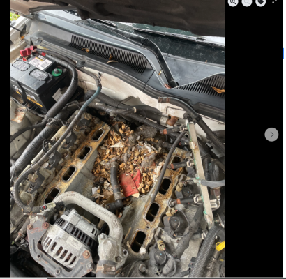

My car had been sitting a long time and rats made a real nest in the intake valley. There were too many rusted fasteners for me to deal with it so I farmed it out to a local guy who specializes in performance, restoration and repair of all gens. He suggested an unhook of the cmcv system while he was in there and since he has decades of experience I figured sure. So anyway he repaired the rat damage and the car runs great; it does set codes for runners since the cmcv is unhooked. But on warm or hot restarts it does stumble and bog horribly; it goes away after a couple accelerations but it's just kind of annoying and embarrassing. Maybe the ecu is trying to detect the cmcv and making an adjustment when it doesn't see it; idk. Anyone else experience this? TIA preesh

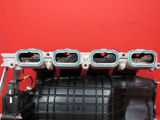

Do you see those butterfly valves? If they are closed or lying flat, they are choking off the air flow. They linkage he unhooked is preventing these from opening. So either remove the butterflies and fill the holes or reinstall the mechanism so they work properly.
