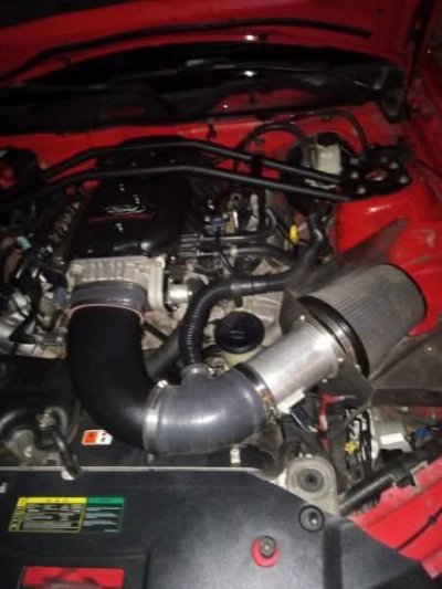

I have a 2010 Mustang GT and it has full bolt ons. CAI, Bbk long tube headers, borla exhaust, cat delete, Twin 62mm throttle body, Ford Racing Manifold, N2MB Wot box for no lift shift. I spoke to the original builder and 1st owner that did everything except the wot box and he said he never tuned the car. I tried contacting 2nd owner and no luck. I suspect it possibly has a Popcorn Tune due to all the popping and crackling it does but I'm not sure. I'm looking at ordering a SCT X4 tuner + Lito tune. I have never tuned a car before so it's going to be interesting.
Anyone that has tuned your car, how difficult was it to do the first time? I'm sure between my husband, myself and Lito Support we will be fine but I am a little nervous.
