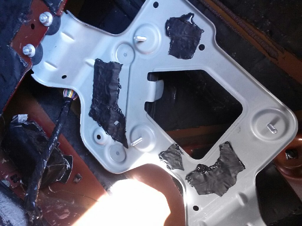

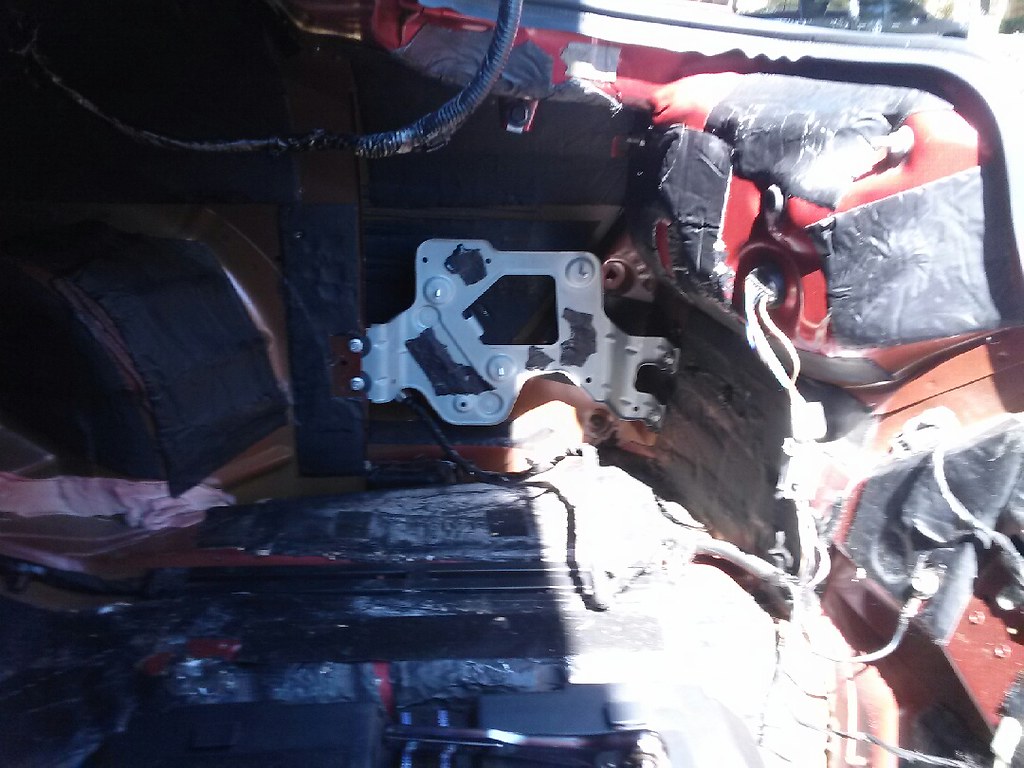

I've already gone over the bodycontrol module, adding deadener to both sides of the bracket, tightening the mounting nuts from module to the bracket, and added rubber washers behind the mounting points. Removed that carpet bolt as well. Gonna take the car out again this evening when traffic dies down a bit.
