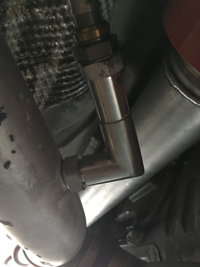

Never heard of this company before.. So where do you connect the rear 02 sensors on these, or do you weld/clamp them on an off road pipe that already have front and rear 02 sensor connections :shrug:
I think they were a vendor here for a minute. Some of the turbo guys were running them that are no longer active on the site. I've purchased hose clamps and tbolts from them. All good stuff.
I haven't done these myself. I'm tempted to. If I were doing it I'd be trying to mount them oe-ish with some defoulers to keep the 02 sensor away from the dirty. I'd probably go way over board and use something like this.
http://www.bigdaddiesgarage.com/mini-cat-cel-fix.html?gclid=CjwKCAjw_8jNBRB-EiwA96Yp1kd84_XGKoch1K9Josjcdof0tMko0wYIkGGEQzBHLyr2KZP4CekohxoCcKUQAvD_BwE
I don't know of people running them in the domestic scene but I have a couple dsm/evo and a couple bimmer buddies that swear by them.

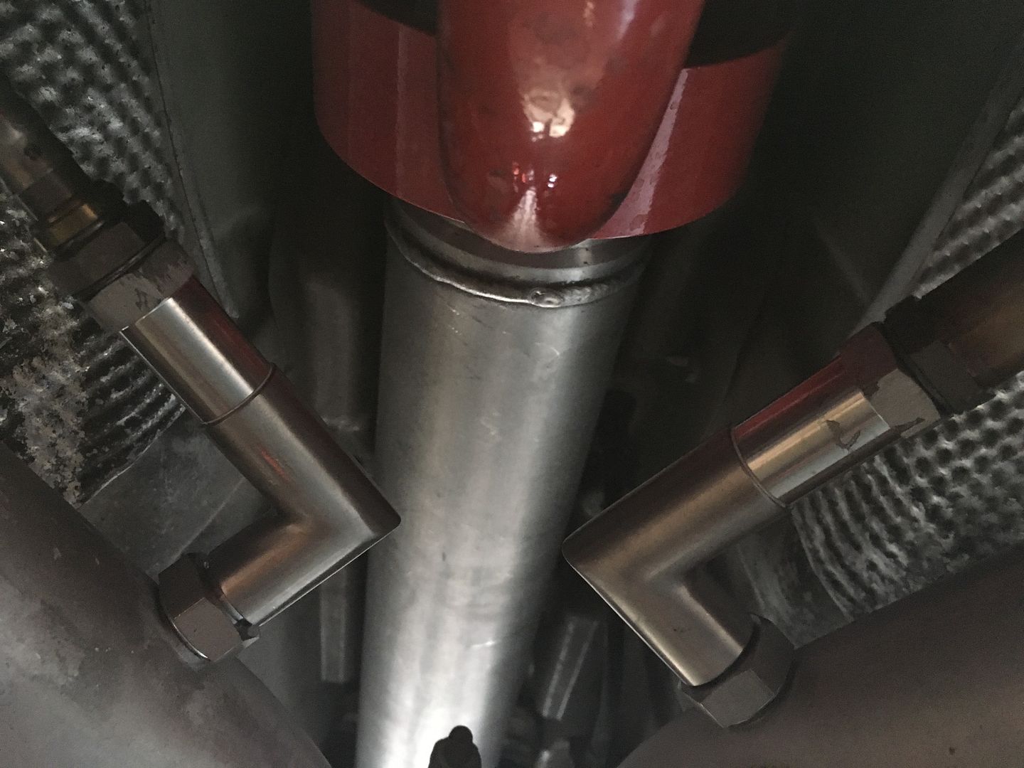

http://www.bigdaddiesgarage.com/min...f0tMko0wYIkGGEQzBHLyr2KZP4CekohxoCcKUQAvD_BwE
I use those and pass the OBD smog test every year. I had to get the 90* extensions as there was not enough room for my rear O2 configuration.
