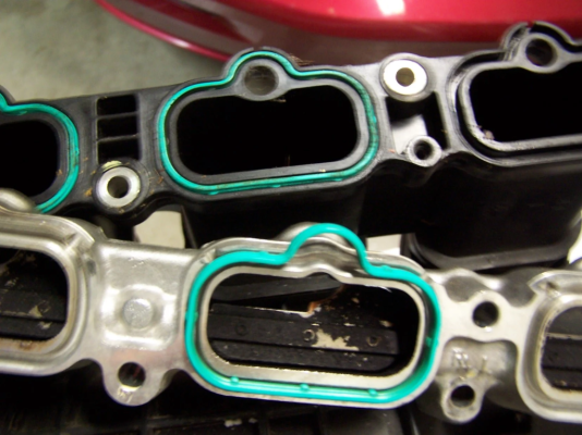

They have a slightly more pronounced hump than the lower ones next the block, had mine off recently too and realised I couldn't use the spare set I had for the bottom. My old set was still decent so I put them back on again. i took that lower picture from an online search as i forgot what exact shape they were. Only set i can see which look similar is the 5.0 coyote? maybe worth a try if you cant find a set.
