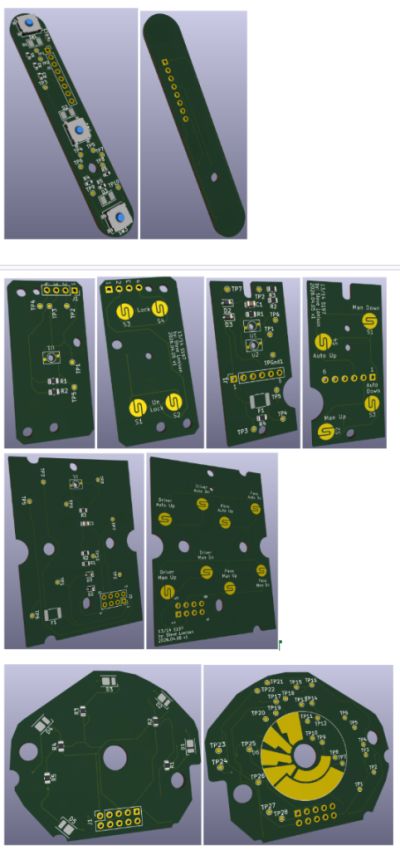

I've completely lost my mind. I'm redesigning them by actually integrating them into the board. NO MORE RIBBON CABLES

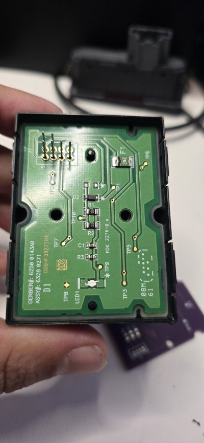

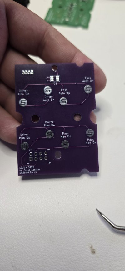

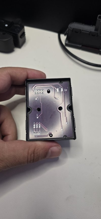

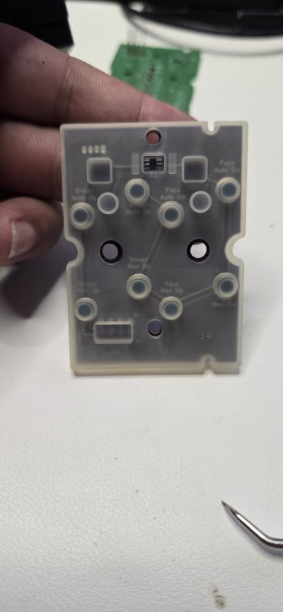

Finally had some time to get back into this. There are some modifications that need to be done before testing, but, here is one of the best prototypes as far as fitment on the first try.
Original
RGB
The last image really shows just how good my measurements were. The LED fits right into the diffuser socket and all the carbon pills line up with the pads perfectly.
