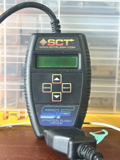

I also learned that a low idle can cause vibration when the car is in gear at a stop. I'm using an SCT tuner that lets me adjust the ECM settings, and I found I could raise the idle from 600 RPM up to 900. I set it to 800 RPM while in gear at a stop, and that completely eliminated the remaining vibration.
The car is running great now — smooth at idle and totally vibration‑free.
