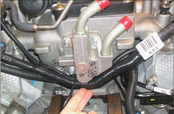

Hello everyone!
Is it possible to open up the inlet and outlet on the back of the Roush Intake Manifold? VMP sells an upgraded intercooler brick but getting that seems pointless if the inlet/outlet passages are still at barely 1/2".
