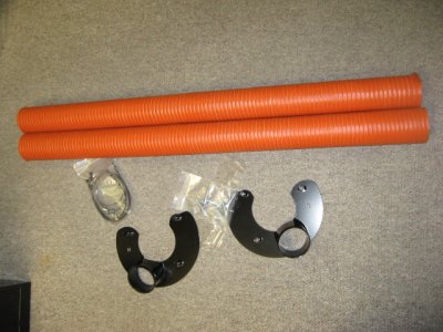

I have a few boss parts in stock, Which I will be using on my project vehicle..
A few people asked me to post pics of the product..
Includes powdercoated backing plates and 3-inch dual wall silicone brake ducting temperature rated at 550 degrees F
Designed to fit 2010-2012 GT/CS lower fascia insert fog lamp opening
Reduces front brake temperature by ducting air to the brake rotors
if you have any TECH questions, feel free to PM me..
Ryan

sorry guys.. if you want the length of the hoses or any other tech info. Please post your question...

are you able to post up the instructions that came with it? I looked into the agent 47 kit in the past but that one required the washer fluid tank to be relocated
RDK
Oct 21, 2009
1,823
the instructions are 10 pages long.. I would be more than happy to write something up .. The pictures in the instructions are black.. and Very tough to see..
PBstallis
Jun 13, 2010
213
well than I guess my only real question is,, does the installation of this kit require anything(coolant tank,washer fluid tank, etc) to be moved in order to fit?
thanks
RDK
Oct 21, 2009
1,823
No,
you do have to have a CS lower grille.
Basically, you remove the wheels and tires, remove the inner wheel wheels, remove the front fascia, pop out lower grille, drill the fog light holes bigger, attach the hoses
replace brake shields with the new ones, and attach hoses
the put everything back together, you will Zip Tie the brake duct hoses to front sway bar, so if you want to go with an adjustable SB up front.. you should do it while the car is apart..

Why do you have to drill fog light holes out bigger?
I put on a Steeda kit and the 3 inch hose fits onto the rear of the foglight opening. I did remove my Washer tank but since I never drive in the rain, I don't need it and it also saves weight off the very front end of the car. I also made an oversized spindle mount since I installed Baer Pro plus 14 inch brakes.
steveespo
Sep 22, 2010
155
If you have the fog light inserts you do not have to drill anything the hoses go on perfectly, if you have the blank off type insert from the Boss 302 then you have to drill, there is a dimple on the back side that centers a 2 3/4" hole saw per the instructions with the kit.
