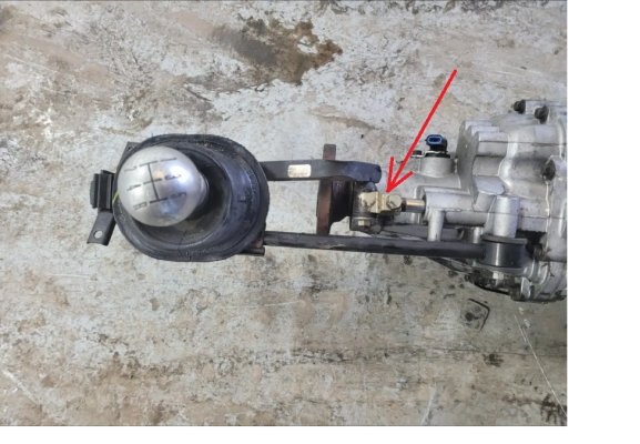

Hey so im having a real trouble finding parts for my tr3650.Im manual swapping it and the linkage part of the shifter is hard to find along with the little knuckle piece that bolts onto the shifting mechanism.If anyone has that part or the whole shifter assembly for a fair price let me know.

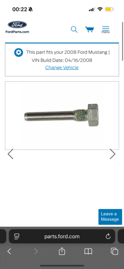

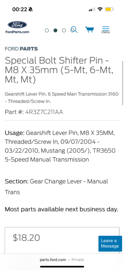

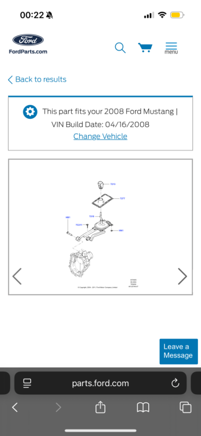

I had this shift linkage bolt/pin snap twice. The ford part number is 4R3Z7C211AA. You can buy it directly from ford online.
