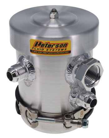

Great set up. The best catch can is actually a Peterson 08-0420. Having the external breather can get very messy. Most race shops suggest the peterson now.

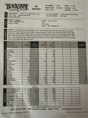

Not to jump off topic too much... what kind of info do you get from the oil analysis? How much does it cost?
Over the years I have read several of "Bob the Oil Guys" forums, but never sent a sample in...
Also, nice bully in your sig pic.
Thank you. She just turned 11, Pandora's the best, smart and stubborn.
This is the one I got from my mustang when I did it back in 2019. I do it on my 6.0 F550 whenever the oil gets changed. They keep all the data on one sheet so you can see trends.. I've only done it once on my mustang, just to see where it was at.

This is the report you get from Blackstone. It costs around $40. I couldn’t find the one from my Mustang so here’s my daughter’s CRV. Find their web site to request kit. It will contain instructions on how to take samples. 8C5BD780-23F1-4498-94D7-F68271E9ED03.jpeg
