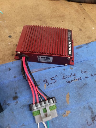

Hey guys I have this BAP module that came with my mustang I recently purchased. The way the pigtail is wired is how it came and I'm trying to figure out how to activate it. I found out that the first from the left red wire is input, 2nd red is output, and black is ground. That leaves me with 2 smaller sized wires a red and black. I assume these are the activation wires but jumping them together didn't boost the voltage.

I decided to give it one more try after posting and got it to work. I am testing it on my workbench using a 12.4v power supply and got 17.3v out when jumping the 2 smaller wires together.
