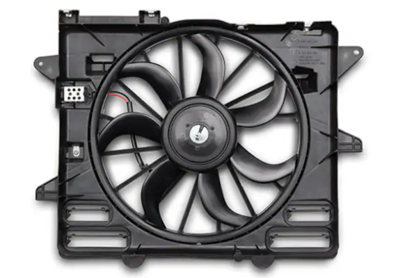

Thanks very much for all those constructive comments. That will help me a lot. We imported the GT California Special 2008 (had it converted here). It’s traveled 115000 miles on the Australian roads and I have really begun to research proactive maintenance projects- primarily to assist longevity. Secondly, to assist 1. handling, 2. performance, 3. comfort (NVH) and 4. Integration (a synthesis of all earlier categories. I have had zero problems with the cooling system, though thought a total refresh may be sound. I have the 7 fan Gord Performance cooling fan on its way from USA. Already have new upper and lower rad tubing ready. Have new OEM style water pump on shelf, plus new thermostat. The tricky issue (thus my inquiry) had been to learn more, and make solid choice re the radiator.
