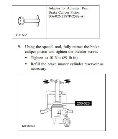

I used this method, to retract the rear caliper piston. You can buy the special tool at Harbor Freight, eBay, Amazon etc. It rotated like the old Lincoln rear calipers did. That's why trying to squeeze it doesn't work so well.

I rented the tool from my local Autozone. I will say that I have done them before with a c-clamp and channel locks, but you run the risk of tearing the dust boot. ;)

For the front's a clamp is fine but if you're not rotating the backs as you push them in you'll mess them up.
