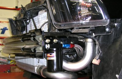

Follow-up. Guys at Dynoedge in Albuquerque figured it out. Used a Canton remote filter kit, 22mm filter block adopter. Clean set-up, see pics (one with bumper off, second shot from under car looking up at filter, inside of bumper). Kit was about $350, top quality.
Bumper clears no problem, no leaks, no problem getting to filter now.
Same place that I mounted mine. But I didn't use a kit that cost that much. Got a generic one from Summit that cost about $40 and mounted it myself. So far I have had no leaks and everything is tucked up nicely.
ditto, paid $7 for the screw on adaptor and i think $12 for the remote oil filter bracket,then about $50 for SS hoses and fittings.i put mine in the same spot also.
