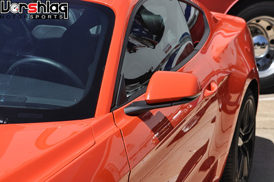

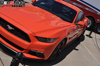

I know there is a lot of controversy with respect to weight on the S550 this week - Steeda said over the weekend that it will be +200-300 pounds over the S197, then backtracked and admits to not weighing a car. Car & Driver today says +250, but also haven't weighed squat. These rumors got me all spun up, pissed off, and vowing to cut up our new 2015 GT as soon as it arrives... this "weight speculation" is ruining the S550 before we even get a chance to flog it. Or ACTUALLY SEE ONE ON SCALES. This could all be bullsh*t, or maybe they are right...
click above to watch Vorshlag's 8 minute video walk-around of a Pre-Production 2015 Mustang, inside and out
About four weeks ago, Jason from Vorshlag and I got to poke and prod a pre-production 2015 Mustang, shown above. This was the third pre-pro S550 we have seen, but the first one we could get our hands on unsupervised. I as stated in my S197 build thread update posted earlier today, we actually skipped competing in an SCCA ProSolo to be able to see this 2015 Mustang - and we had hoped to weigh it, drive it, and do a data dump from the OBDII port. And while we didn't get to do those three things, we did get to sit inside the car, I did my typical "helmet test with a tall guy" seat/roof inspection, we measured the track widths and poked the vidcam inside and under the car for a better look at some suspension bits, wheel clearance and interior room.
Take a look at this video above as Jason and I discuss engineering aspects of this chassis, like the little aero smoothing and drag reduction tricks that Ford has done on this chassis. It is actually really slick, and I think it will show in both increased fuel economy and higher speeds on track. We look at the exhaust routing, suspension components and wheel room as well.
As soon as we find a production S550 within 100 miles of us we will immediately take our scales and weigh the 2015 Mustang and post it here. Hoonage, track testing and suspension development work will follow as soon as our car arrives, which we have been assured is one of if not THE first GT to hit Dallas, Texas in about 6-10 weeks.
