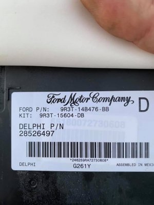

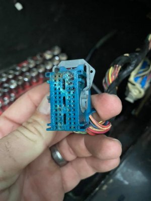

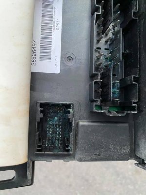

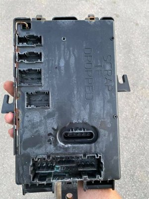

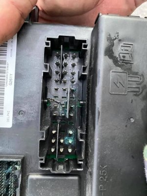

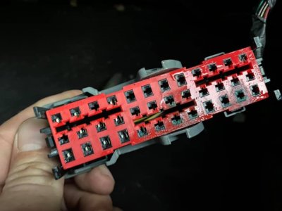

So I've spent the last few days researching the dreaded water leak and the SJB problems to troubleshoot my mother's 09 GT. The complaints were obviously the passenger water leak, battery drain, radio staying on and some other various issues with electrical and HVAC. Pulled the SJB and there's water/corrosion on the connectors and SJB. What continues to puzzle me is the various searches throughout many forums, I see contradicting posts. This is where I need clarification so I order the right thing. I've seen the coupe to coupe, part numbers must match, has to be reprogrammed, it's plug and play, etc. Her SJB is 9r3t-14b476-bb. When searching, I can find many with different first four digits and then some with last two digits different. Just need to clarify prior to spending the money. Thanks.

Just call a local Ford dealer and give them the last 8 digits of the VIN... They can tell you exactly what part number of SJB fits that car.... Their might be a couple digits different if there have been any revisions for that part.

So bit the bullet and called my local Ford parts department. He said that as far as the numbers, they've changed the engineer numbers like 19 times. Told me that as long as it's a coupe from 05-09, should be good and it does need reprogramming.
Part numbers over the years for all manufacturers can/will superseded many times over the years. SJB doe need programming to the vehicle.
