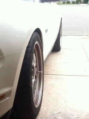

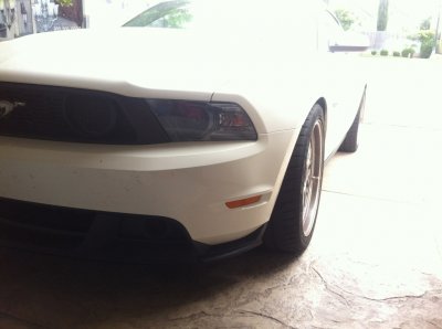

I run 19x10s in the front but it's not very graceful because I need 15mm spacers. If the wheel had a little more spoke clearance (like sve drifts, RTRs, or Linea corse lc818), you could run 10" wheels with ~40 offset all day. Here's what mine ended up looking like:
ImageUploadedByTapatalk1344813889.770090.jpgImageUploadedByTapatalk1344813934.863176.jpg
Vorshlag managed to get 18x11s up front (don't know how much extra clearance their coilover strut allows them) and 18x12s out back with 315/35 tires all around. They used a 12" wheel out back in hopes of running Hoosier's 345/30/18, but that turned out being too big of a tire. It takes camber up front, but that shouldn't be an issue for a track setup--Fair@Vorshlag runs almost 4° of camber in autoXs though, and that's a bit much for a road course. I think you can get away with less. The biggest reason for running 10.5+ wheels would be to run 305/35/18 r888s or 315 Hoosiers. otherwise you can do 10" square wheels with the same offset front and rear with 275s or 285s all day with plenty of room to spare.
Hope this helps

What is the weight of those Drift wheels in 18x10?
Also what tire size are you running in that pic? It seems as though all the wide/sporty 18 UHP/ExtremePerformance Summer tires are a bit short compared to stock OD.
