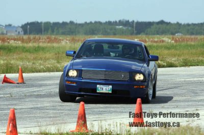

I have the same springs and steeda bars, I have fairly moderate body roll.
Understeer during autocross is usually driver error. It's a lot to ask 3500+ lbs to change directions quickly.
I was recently at an autocross school. I went through a short course about 4 times then my instructor took the wheel to show me a couple things. First run, first time driving my car he beat my best time by 1.3 seconds (all while getting the car a bit wild at times getting used to 400+ torque). All the places that I understeered, the car rotated nicely for him. Autocross is driver, driver, driver, tires, driver and then all that other stuff. Getting the line correct is huge. Often going slightly slower through one section or element will improve the line for a subsequent element and ultimately lead to a faster time. I was surprised how a few subtle changes improved my times.
Basically, if you are anything like me, fussing over pressures and settings is just fine tuning as mentioned. The major part is improving driver skill. I wouldn't change anything at this point. Between autocross runs I generally don't change pressures or settings much, I try to figure out how to fix what I just did wrong.
