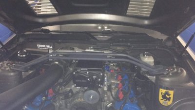

I have a 2.6 later Stage 1 Kenne Bell on the4.6 V8. None of the standard strut braces fit this supercharger. So I had to make one. Relatively simple really...made a few for my mates too.

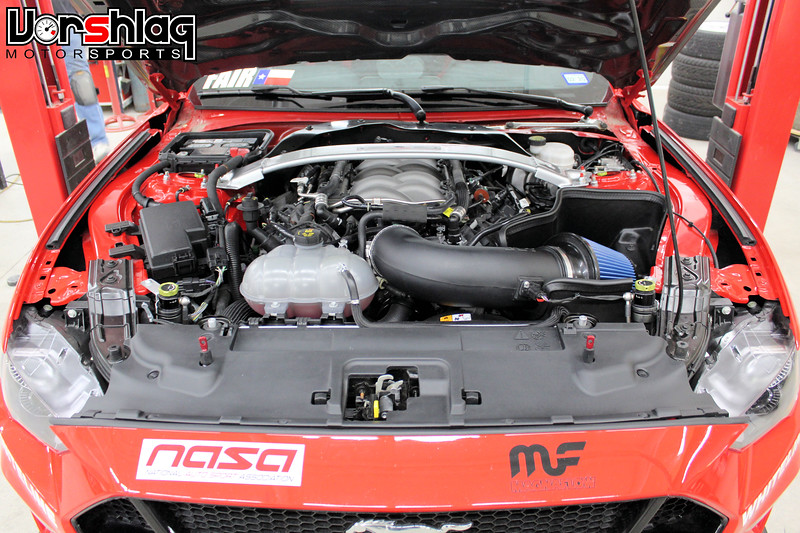

I've had the factory 2-point braces on two of our heavy track Mustangs, including our S197 at the top and our '18 GT S550 above. I am of the opinion that if Ford decided it was worth the cost and weight to add these simple braces, how can it hurt? The strut towers DO take a tremendous amount of suspension loads through them.

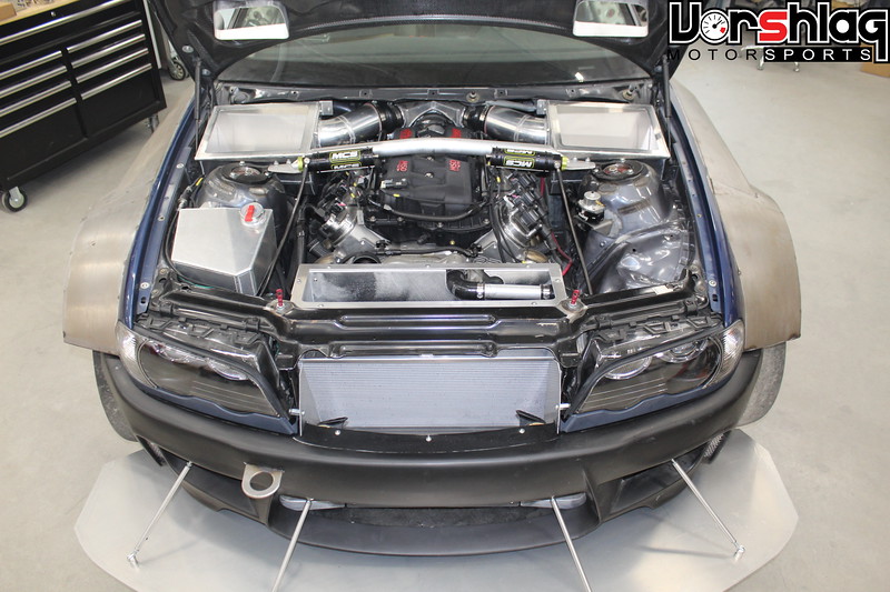

Now on some builds we will add a STB simply for aesthetic and convenience reasons - they can often make a great place to hang shock reservoirs onto, which need to be kept away from heat sources and easily reached for knob access.
On some chassis with weak strut towers (BMWs!) we will always add a STB, to reinforce the thin, weak strut tower sheet metal. We've see these towers crack when going over big bumps in these cars without an STB.

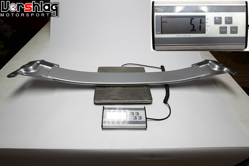

In the end, keep things in perspective. These STBs do not weigh enough to worry about, either way. We are talking about 3600 pound cars and the 2-point Ford brace above weighed in at a whopping 5.1 pounds. That is a .13% change in weight. Also known as a ROUNDING ERROR...

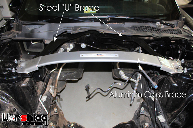

On the S550 there is an optional 3-point component to the factory GT350 brace, shown above. Its another 10.6 pounds, for a combined total of 15.7 lbs. Again, not a big number on a 3600 pound car. This car has a LOT of metal in it.

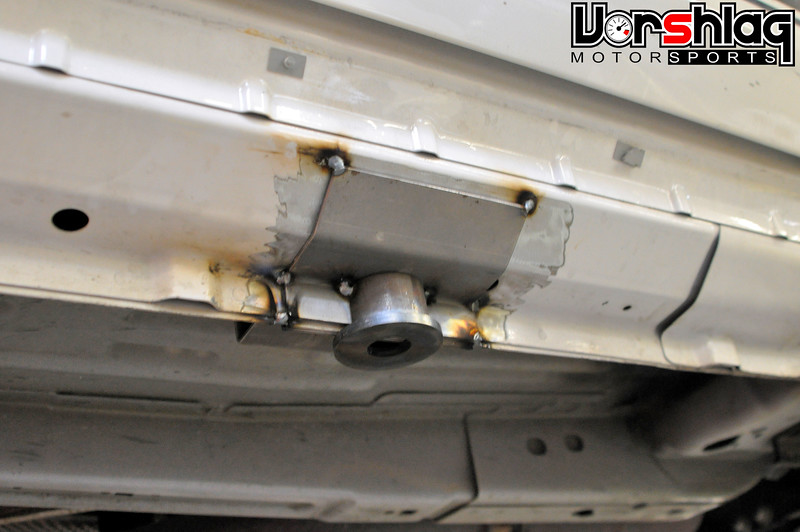

Some of these doo-dads can come in handy, however, like these Watson Racing jacking point kit on the S197 race car above. These are handy AF if you need to do a FAST tire change on one side of a car. It was stitch welded in, of course.
