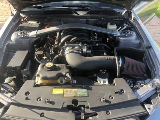

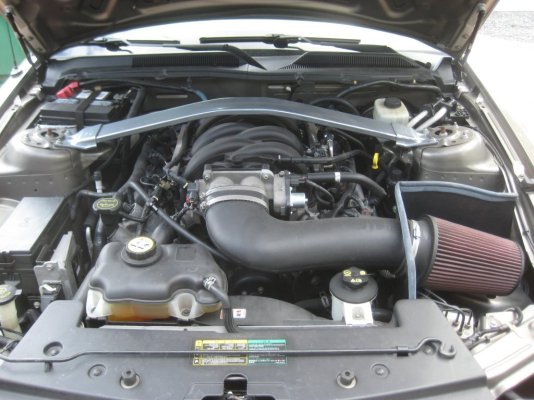

I currently have the Boss 302 on my 05' GT and had it on my 06' GT Convertible (gone but not forgotten). No fitment issues at all...
FYI Sometimes you feel the difference in a mod and sometimes you don't. There are some on this forum that do not believe in the benefits of aftermarket braces adding rigidity to the S197 platform. I am not one of them, I strongly believe in aftermarket braces, and I have them on all my cars (Mustang, Audi, Taurus, Durango, Jetta, etc.)
