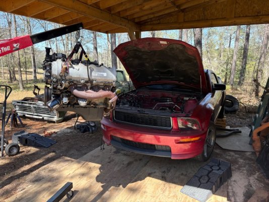

Dino brings up a good point. I guess it also depends on your work space. If you’ve got the tools and space, you can drop the whole thing out the bottom.
The 3v comes out the top pretty easy though, as long as it has stock headers on it. I left my radiator in, pulled the fan, and even left the hood on. Came right out.
