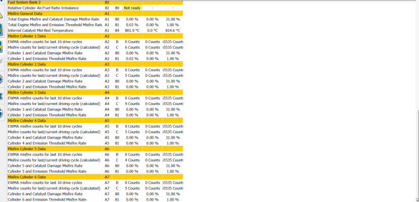

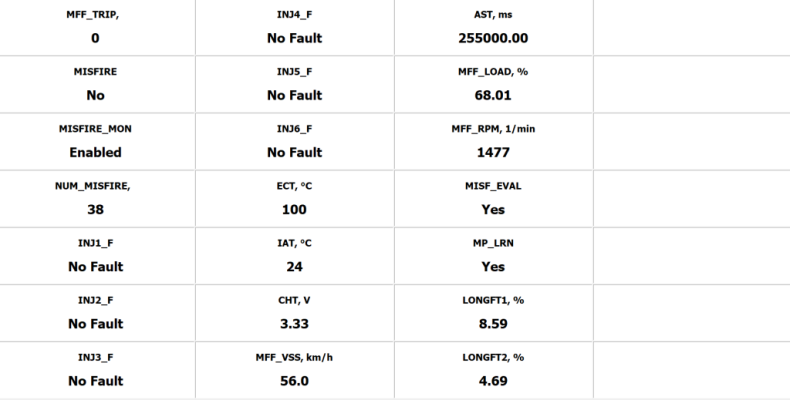

Idle is almost smoothed out now, but a mysterious low RPM misfire appeared (no codes, just appearing in FORScan, please see images attached) and evap/purge valve is cycling constantly, once every 15 seconds. I swapped out EVAP and PCV valves for the new Motorcraft ones, but the behavior persists.
That begs the question, how normal is that for our V6?
I assume misfires are not acceptable at all. First plugs I threw in were Champion Iridium plugs, they worked with no issues, but I got low load/low RPM misfires in all 6 cylinders without affecting the power. I ordered Motorcraft SP520s and replaced Champions, now the engine runs a tad smoother, but misfires are still there.
They usually appear when I apply really light pressure on the gas pedal to keep the speed. They do not appear when accelerating. Crank relearn and adaptation reset was done of course. No vacuum leaks were found with the water spray method.

A true misfire will log thousands of misfires in a short time. If the counter stays near ~10 or less, you are fine.

Compression seems to be ok, although I'd better test it. Plug wires are visually intact, I did not test the coils. However I ruled out the coils because the misfire happens in all 6 cylinders as per attached picture. I figured if they were failing, I'd have at least one or two coils still functioning properly.
