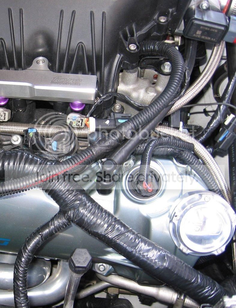

I just noticed something on your valve covers. What did you do with the VVT sensors that come through the valve cover?
lethe
V4g!n@ #er
Jul 28, 2012
4,002
Everett, Wa
Are they not all like that?

That is one cars that dont have VCT anymore. IIRC, you can use a V10 block off plate(might want to search that). I do know that it is nice to leave that stuff on even if you dont have vct anymore. That way ifyou email tune your tuner can still verify cam position.

I was trying to figure out because I'm getting my valve covers ready for the powdercoater. One side I was able to tap a 1/4 npt on the small side but on the larger side I will need to weld a nut on there or a bung in the hole for the 3/8 npt. I'm going to be running -8 vents for the crankcase.

Solenoids were deleted and plugged/welded. I don't think the solenoids have anything to do with cam position in the tune.
I still have cam sensors.
