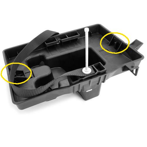

Hello folks I need some help please, dose anybody know what these are for. I found them in my 2005 GT in the centre box when i bought the car. They have some mud splashes on them which makes me think they are from the outside of the car but cannot work out where from. Thanks Russ. 20190928_141004.jpg

There isn't just one size battery that can fit in the tray, but those pieces are so
the group size that is called for, fits without sliding side to side.

Hello thanks for the reply, Its got quite a large battery in the car so that may be why they are not fitted, but its nice to know what they are for. Thanks for your help Russ.

Keep them in garage, in case you change to stock/smaller form-factor battery.

The 05 came with two different battery sizes depending on the option list. My old 05 GT came with the larger battery. It had the optional active anti-theft system, interior upgrade package and Shaker 1000. I think the anti-theft was the reason for the larger battery. Mine didn't have those wedges you showed.
